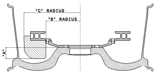

Do you have a caliper template available to check wheel fitment?

Not a full template. But clearance info yes. *Wilwood does not release complete engineering drawings so we can only compute the X/Y coordinates for clearance relative to the "deck" - wheel mount surface.
The required spoke clearance on both kits is .96" or 24.5" (call it 1" for simplification) Add about .100 to that for an air gap.
In the drawing above you'd need a minimum of 1" for Dim A. To check this place a straight edge onto the hub face of the wheel, then measure 'down' into the back side of a spoke at an radius of 7"+ for a 13" kit and 7.5"+ for a 14" kit. (obviously the caliper is just farther from center on the larger rotor)
Another sort of back door way to do this is to search various Wilwood factory kits that show the required 1 1/8" (incl the air gap) and use it on your wheel. Time consuming and their templates are not a lot better as you have to try and blow up the pdf to spec before you can even cut it out. You could actually use the Mazda 3 kit HERE and fudge the clearance a tad. See page 3. Probably just as easy to do the ruler thing I've found.
