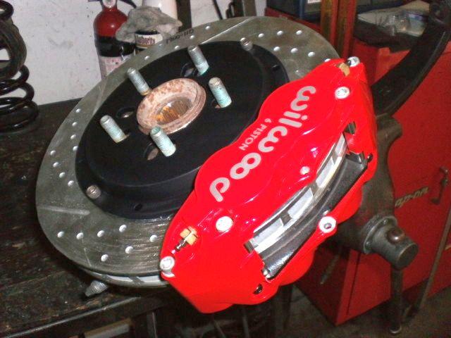

Here ya go.

The new DP6 models shown above are now making their way into regular production of both TCE and Wilwood factory kits!
These should also be available in the same assorted powder coat colors as the former model. And as of late we can no offer you Thermlock piston technology for your more demanding track day needs. These insulated pistons provide greater thermal rejection then the standard ss parts. Done so by way of an air gap, stainless steel cap and a phenolic shim they keep heat at bay~! Normally I'd not be keen on using the DP6 for track day use but the new model with the body bridge and some other changes has great increased the body stiffness for such use and should not be over looked.
Questions, comments, concerns; fee free to inquire.

The newer version of the DP6 is now shipping in all Factory Wilwood kits.
The revised caliper is similar to the former model but is no longer 'top loading' and thus requires the caliper to be removed from the bracket to service the pads. However the added bridging is designed to stiffen up the caliper body reducing flex and distortion.

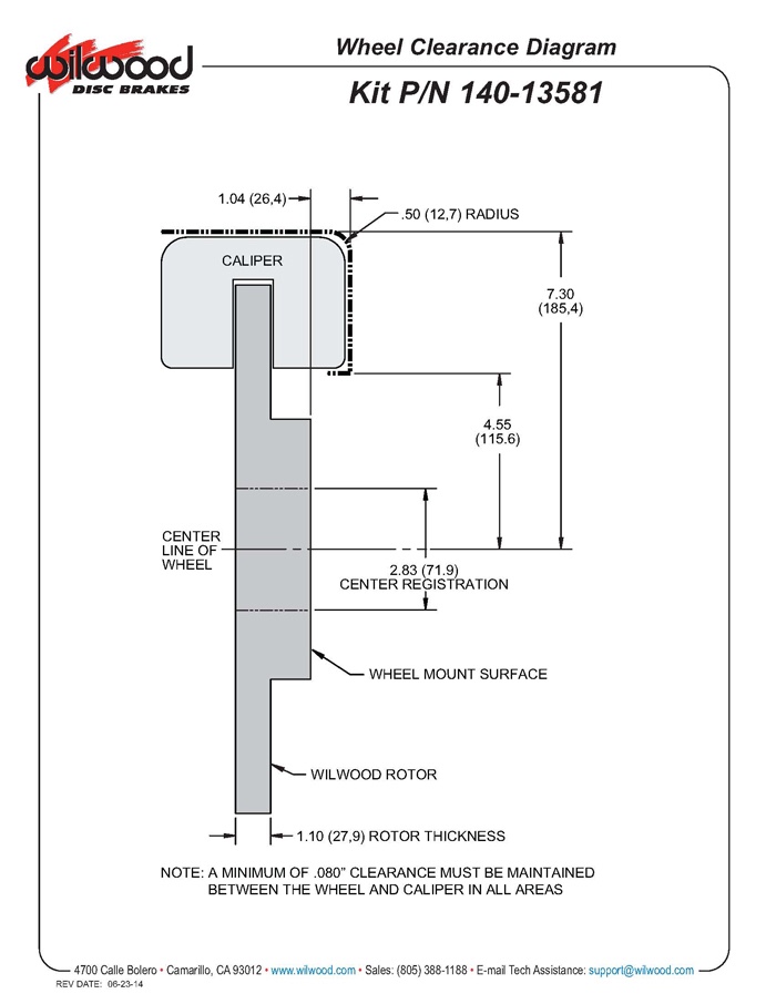

I made a quick 3D model for a tool to verify brake fitment on my RPF1s...
Now I just need to get to a 3D printer!!!

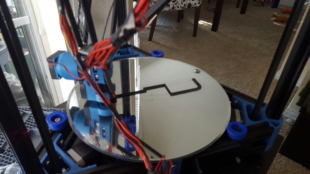

The print has begun!!!
I should have a completed picture tomorrow.

Now time to test fit!!!

Default TCE Wilwood Kits for 3
So I test fitted my 3D printed part and this is what I discovered.
Keep in mind this is for 17X9 RPF1 +45 offset(5mm spacer so +40 offset)
-it will be tight
-I will most likely up my spacer to a 10mm(+35 offset) in order to clear the ID (4.55 dimension) of the caliper.
-the outer diameter(7.30 dimension) is super tight. I was only able to fit a .010" gap gauge in there.
I will be asking our QA guy to measure the wheel next in order to become fully comfortable with the fitment.
Nevertheless I think this is the big brake kit solution for the 17" RPF1 +45(w/10mm spacer so +35 offset)
Here are the pictures from my trial run.

Rpf1's in 17x9" are known for having shitty BBK clearance, no surprise here.

Fully agree.
However it will be a surprise when this kit does fit!

no inside wheel weights for you... no gravel roads and no wheel deformation I was concerned about how close the caliper is the stock GenPu inside edge of the spokes but you have me beat by a good margin.

@Todd@TCE;
On the wheel clearance diagram it has a note:
a minimum of .080" clearance must be maintained between the wheel and caliper in all areas.
Do those dimension already have the .080" added to them? Or am I supposed to add .080 on top of 4.55 and 7.30?
This answer will make or break!

That's .254mm or .010"...

That .254mm or .010"...
BOTH!
Those distances are exactly the same in different unit of measures.

Yes. But it isn't .01mm like you posted.
That would be .0004"
Thank you!!!
Original post corrected

Been in and out of town on work and racing related activities...
The diagrams reference the air gap (of roughly .120" normally) to the dotted line.
The "actual" caliper clearance required (to the body, not the dotted line) would be .898" or 22.8mm.
This is calculated by the use of:
Hat offset- .472
Hat face- .270
Caliper overhang- 1.64
Plug that info into the CALIPER CLEARANCE CALCULATOR
*Please keep in mind the data for this is pulled from their parts. But I'll openly tell you that info and the real world part can vary some. Right now that "hard" number vs the dotted line is .140" which I feel is a bit optimistic.
