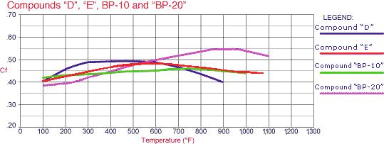

Go to the BRAKE PADS page and you'll find the data is clearly listed by compound. Each compound has specific pros and cons. And unlike most brake pads you won't find some long bs description of how they function- you'll find the Coefficient of Friction table that shows you the projected pads performance over a broad temperature range.
Charts like:
And:

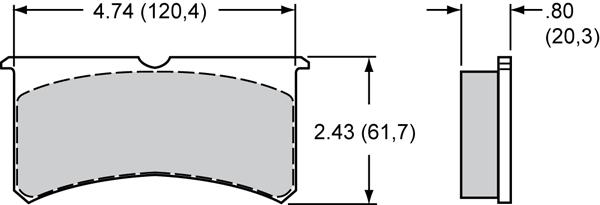

Click the pad part number to view the pad shape. 6712
Or: 7420
