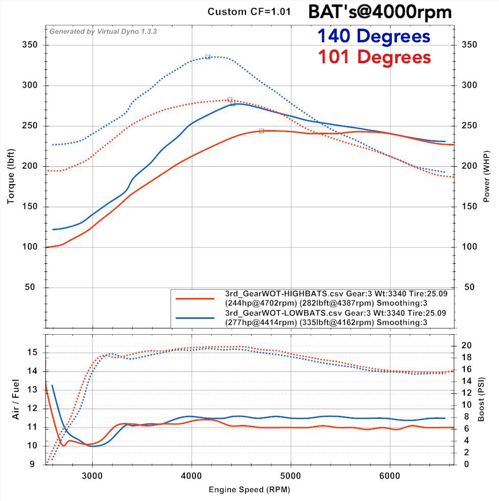

Well. The E33 tune has commenced. Base map, so far. The high was 111 when I took the "high BAT" log and after a 41 mile drive home, to see how it effected my power.
I could always feel that there is less power in the hot temps. But, I had never noticed how big the hit was that a turbocharged car takes, in summertime. A 33whp drop in the afternoon compared to morning. Wow.
I'm guessing the power falloff, past peak, is due to it just being a base map. Can't wait for the first revision. I'm definitely keeping my logging runs during morning hours.

Yea BATs KILL power. I was sitting at an in n out drive thru and by the time I left my BATs were at 194 and the car felt like I had as much hp.

Yeah, when I was top mount, I saw 190's in drive thru's. No good.

Originally Posted by PurplFox View Post
Makes me wonder why my tq is so low. Besides damn humidity. Mines on rev2 of e33
showing 270's hp 310 tq.
Finally, These are "my" two recent Rev 2 logs, in vDyno, I just got to Justin.
I think its just weather factors for sure. My first pull was done on a different day than the second. I always use the same stretch of road and start at the same point. At the same peak point of the blue run (274), the red run was 288. 14whp difference, at that point. The jump to 310 was the timing stepping up to 17 again, I believe.
