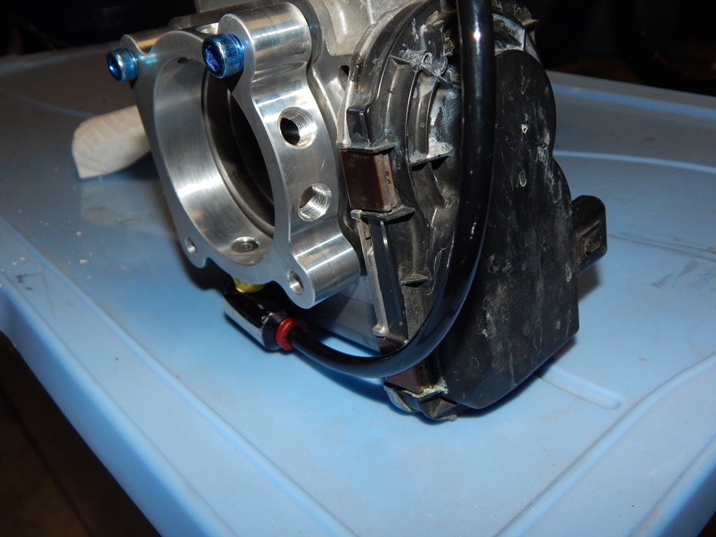

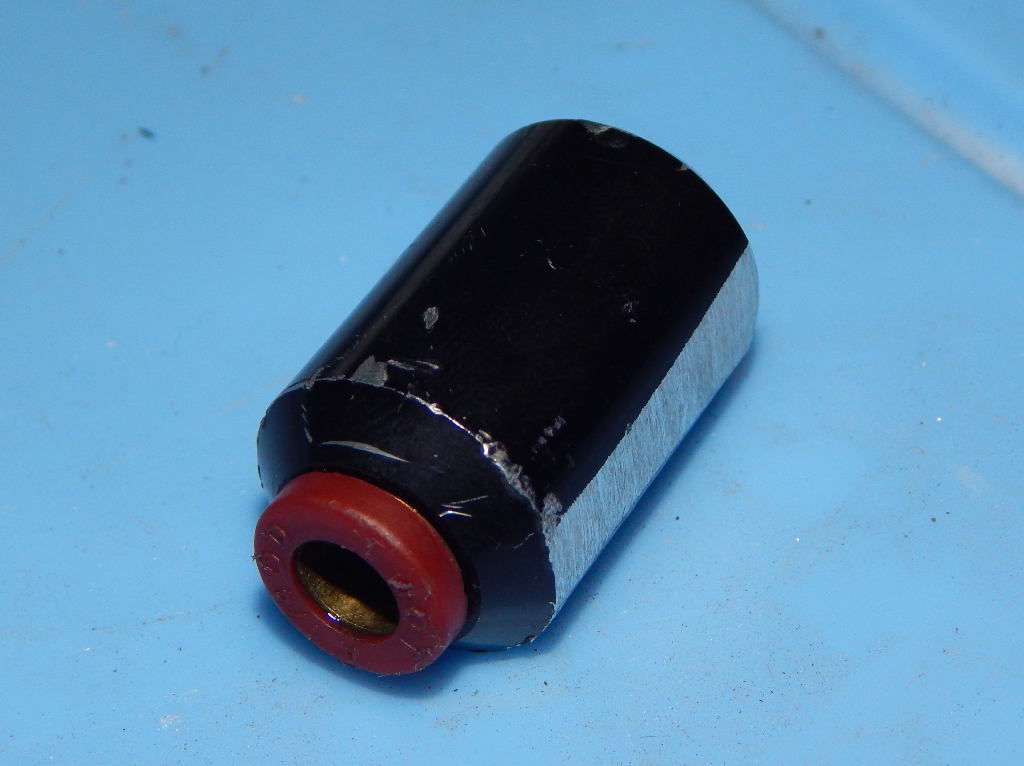

Here's where I ended up. I don't think there's any reason to even bother tapping the top and front faces of the adapter IMO. There's no clearance to clear a holder under the IM on top nor is there clearance to get around the drive by wire assembly on the TB.
I ground the sides of my DO holder so it squeezed between the TB and the IM on the bottom. I did it slowly and kept it cool so it didn't melt the plastic hose inlet. It installed in the bottom slot and the hose comes in from the front.
