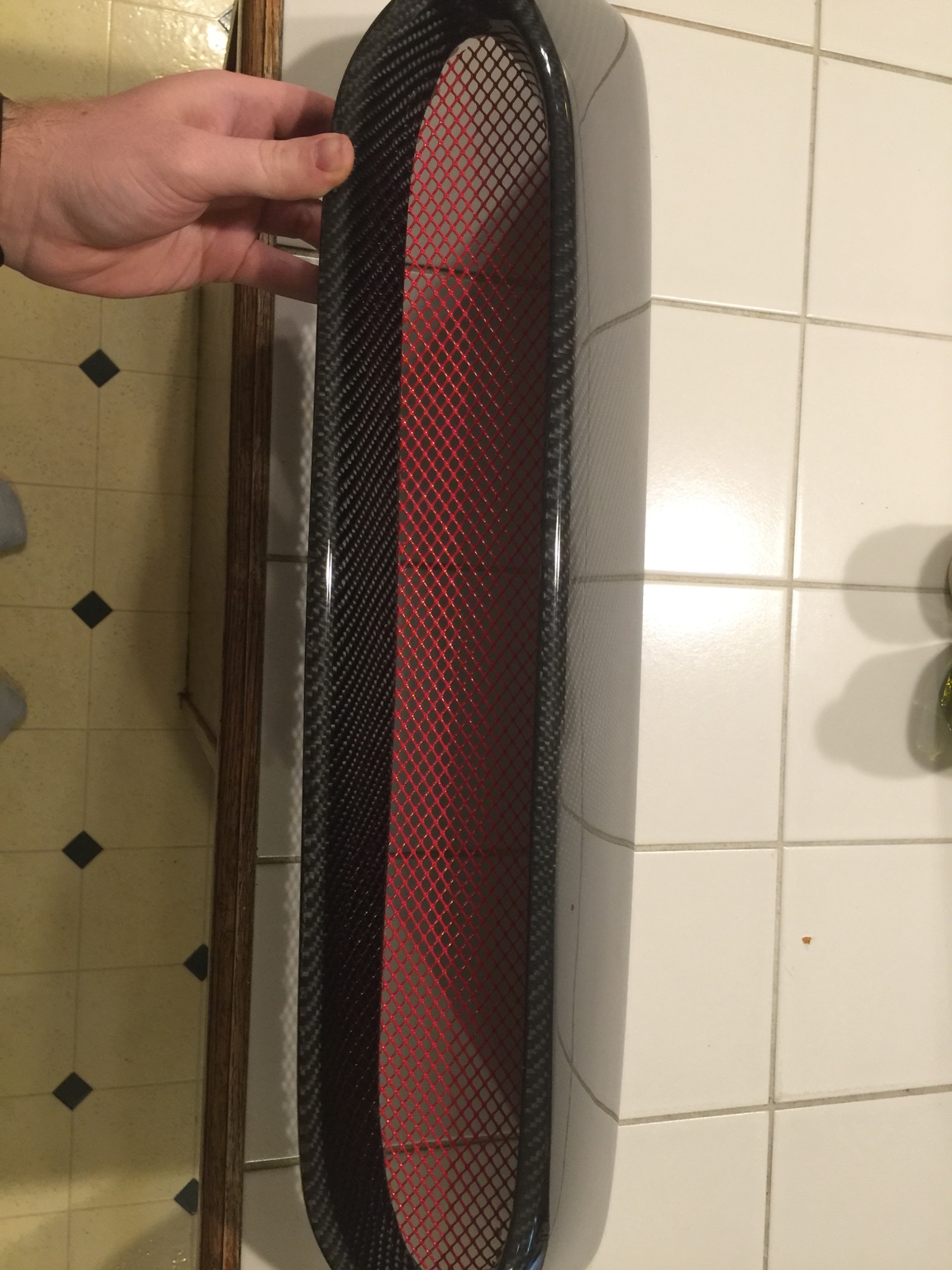

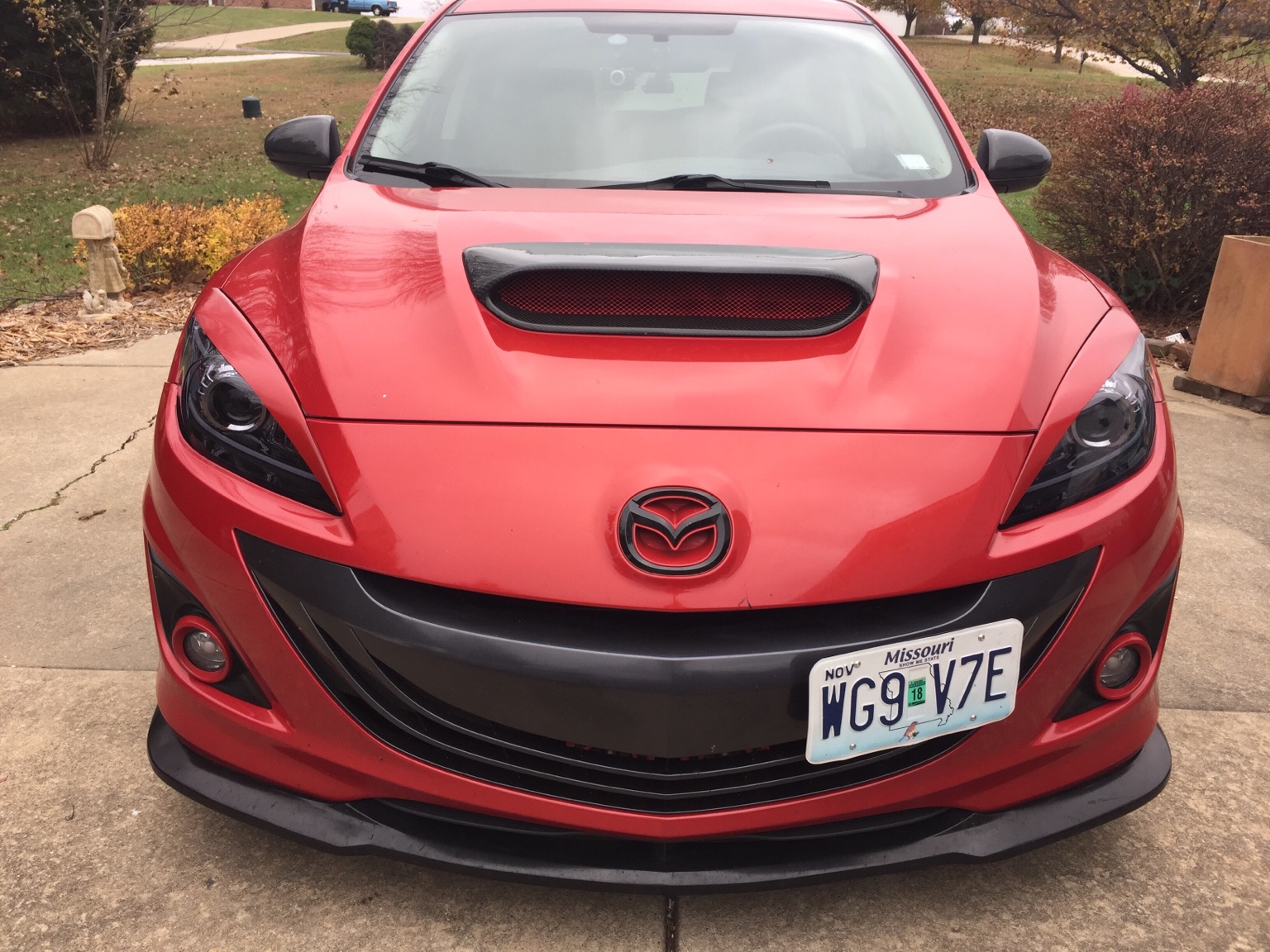

Alright well I've got the mesh painted red and ready to mount and put back in the car. I'll post pictures tomorrow as it is rainy and dark here.

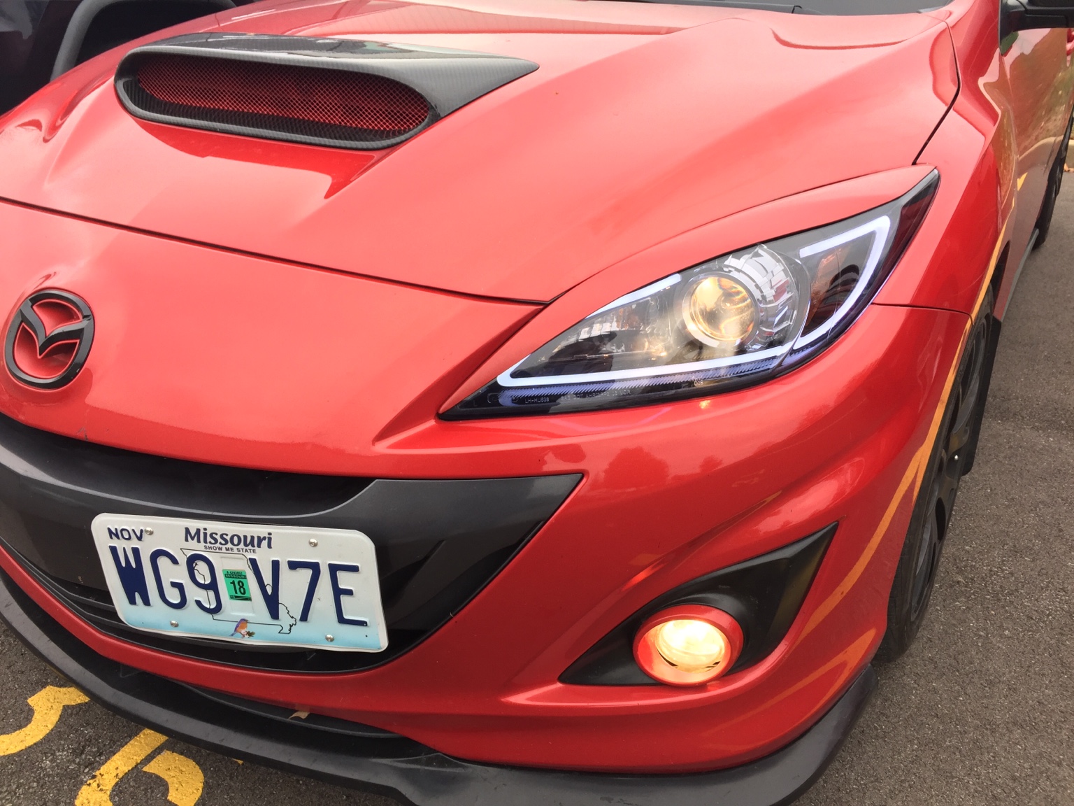

Ok couldn't help myself. Snapped a quick picture.

 Old 04-30-2016, 05:48 PM   #10
Djohns's Avatar
Location: Plainfield, IL
Posts: 3,944   (View Stats)
Thanks: 1,712
Looks nice!

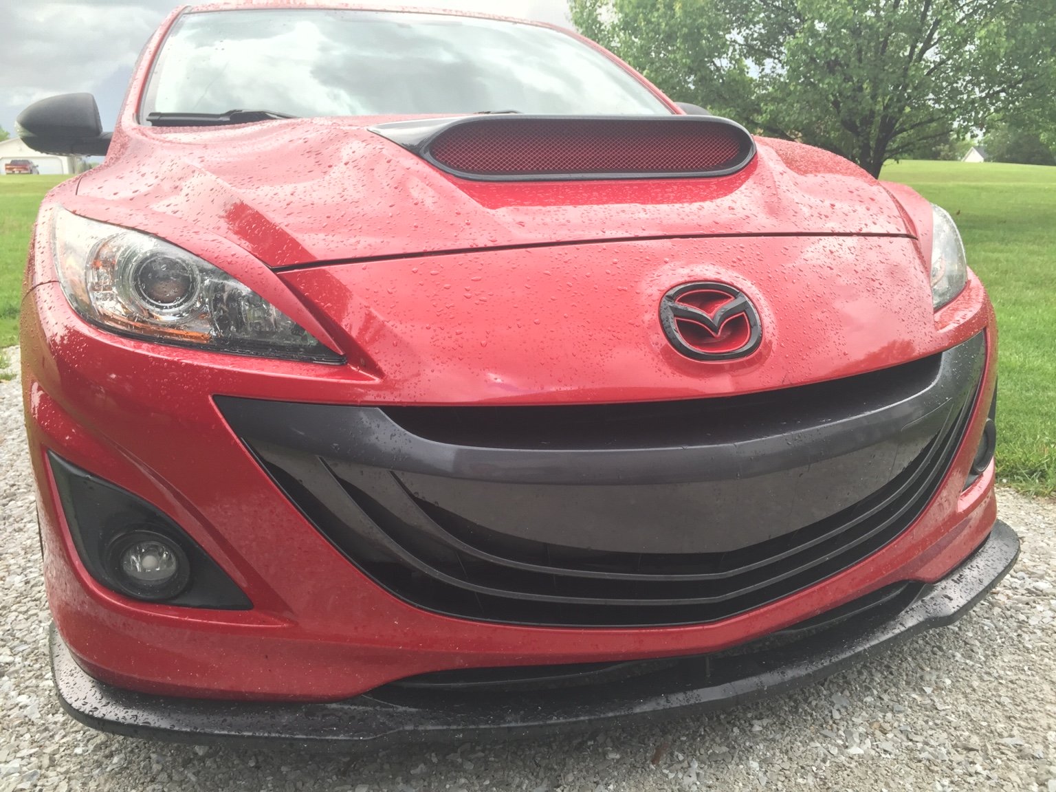

The rain let up so I did get it put in.

I wish I had taken pictures along the way. There wasn't much to it though. Bought rain gutter guard from lowes. Clipped it with sheet metal cutters to size. Then used epoxy to hold it in place. Seems strong.
Looks great! I'm thinking of doing this to mine!!!

What kind of epoxy? Stance boi JB weld yo?

I used loctite plastic epoxy.

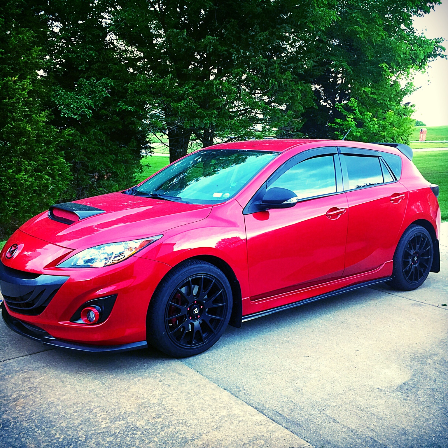

Update:
Still holding strong

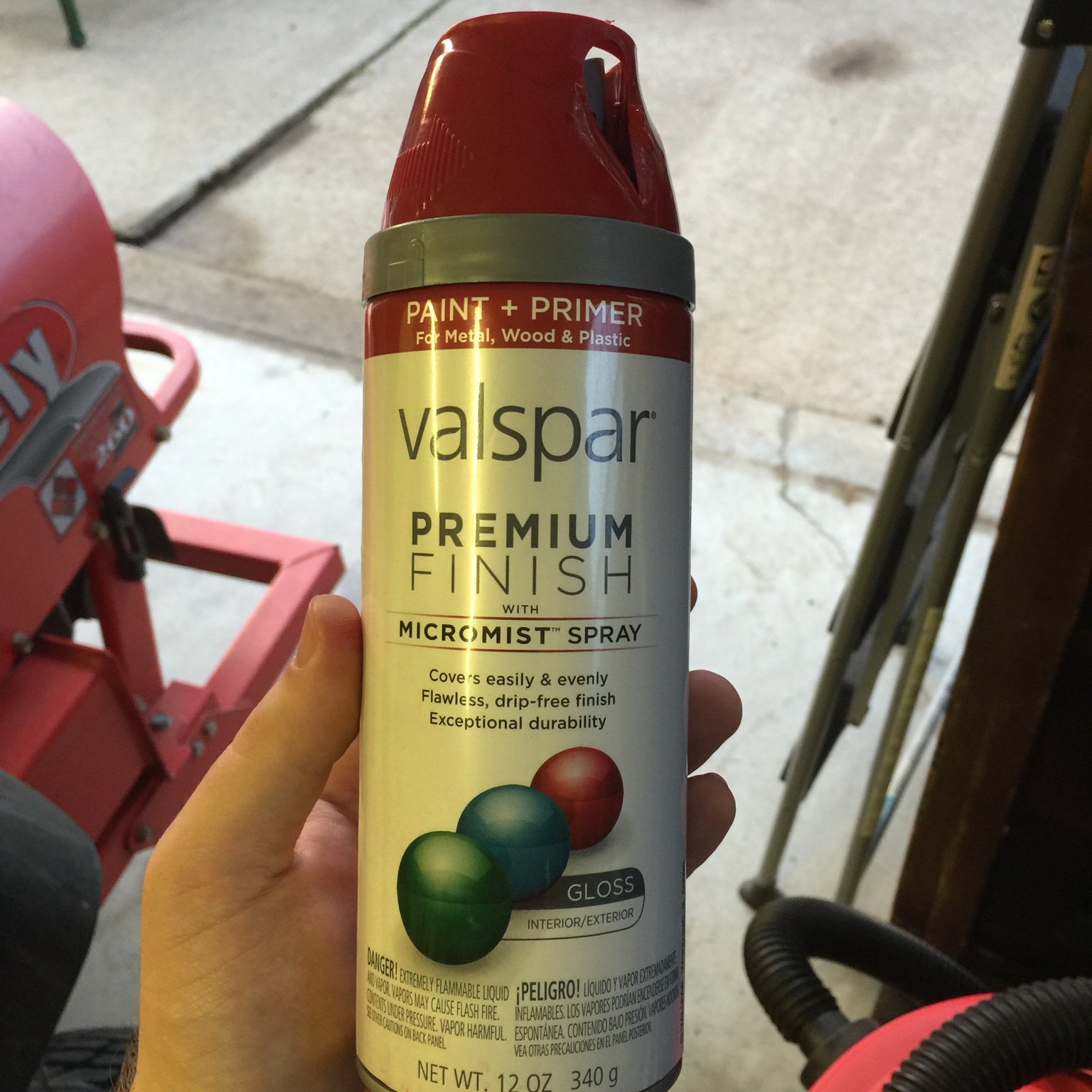

Sorry to bring back this thread, but I was wondering what primer and paint you used? The kind I have just seems to flake off with my nail and would look like shit eventually with stuff hitting it.
