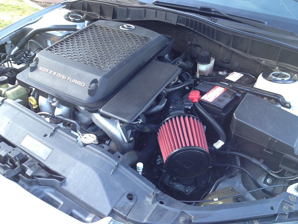

Anyone have any pics of the 3'' intake installed? Been looking around but I have only seen the 3'' TIP and 3'' MAF but not the full 3'' intake, just wanted to get an idea of spacing is like.
 Old 02-05-2013, 08:17 AM   #252
beachshoer's Avatar
Location: Pensacola FL
Posts: 2,039   (View Stats)
Thanks: 659
There IS no spacing. Honestly to go with a 3inch or bigger you need to do something with the batt tray. We put two on at the same time but a batt tray with mine and it's night and day. The other guy ended up buying a tray two days later.
I do have a picture up of mine with the tray. Its either here or in the 400 hp BNR thread.

Ask and ye shall receive. ECU ghetto located because BNR soon and I'm working on a small battery tray of my own doing. Now if you'll excuse me, the coffee enema is kicking in.

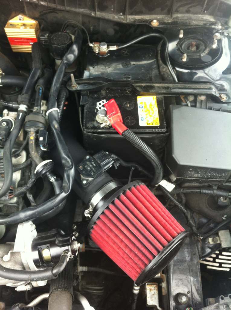

Here is mine with a 3.5" intake. ...I am ordering the battery tray ASAP haha. You can manage but the tray is going to be well worth it.
You need to post a pic with the battery tray installed....

I got mine to fit doing my own batt tray relocation, just had to move it ~1" back. It's snug but you can do it with out buying a tray.

Another horrible night shot but here is the battery tray added. Just for kicks here is the photo with the ECU relocated. Ill try to get day shots later.
