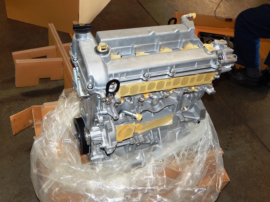

Doing a compression test this weekend. It may not be good lol. This seems like an excellent option

Does anybody know if these motors come with the timing pin installed??? Trying to crank motot by hand just before starting and it came to a stop and would not turn any more. Did not want to force it.
@EdgeAutosport.com;
Did you run into any issues with the motor turning over?
I did but was simply due to having the spark plugs installed. If you want to crank motor by hand first remove spark plugs and have at it, much better option than leaving them in and fighting compression.

NAPA remanufactured block
This guy had low compression after a few thousand miles, he did noticed pitting on the pistons though. BUT, ATK sent him a replacement and even paid him for the reinstall. Read the whole thread for the details.

Originally Posted by Eddie Duranczyk View Post
I got my Remanufactured engine and the tested compression is 160....seems low
Is that right out of the box? Compression will be on low side until ringlands are fully seated after break-in.

Which compression tester are you using? Did you use it right? Engine broken in? was engine warm?

That's what it says on the test sheet. I was getting 185-190 the last time I tested my last motor before ZZB.

These motors should also come with some writing on the gasket box stating compression they tested as I believe they test all cylinders on all motors before they ship one out. Compression listed on box is cold motor that has not been broken in so it will be lower until both items achieved.
