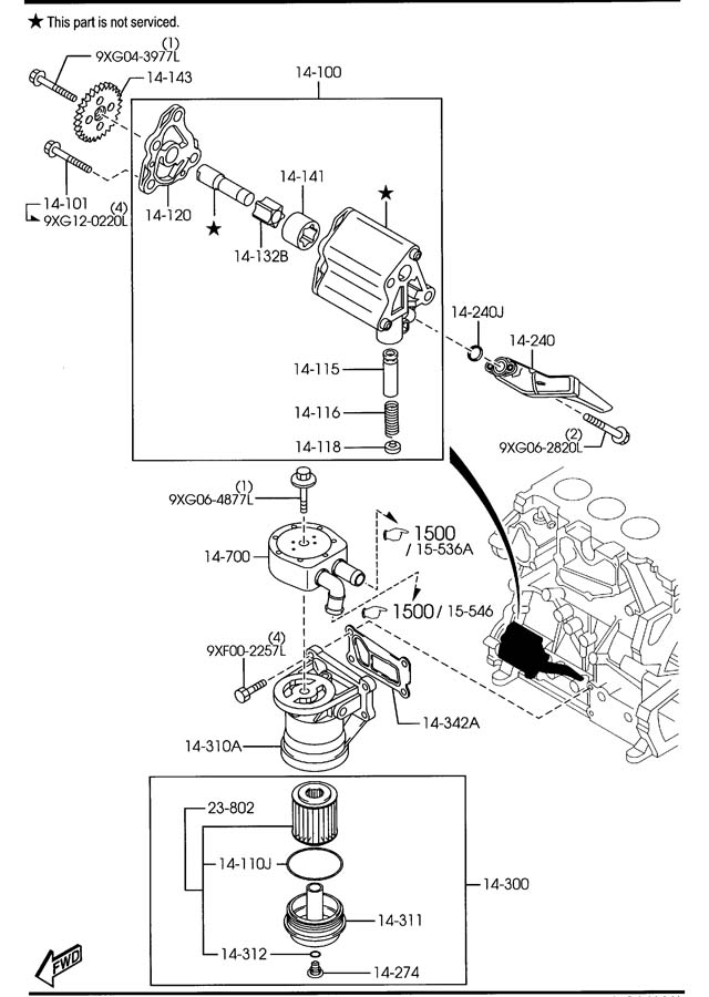

So, I am a dumb and last oil change I stripped the bolt for the plastic oil filter cap. (Image relevant to bolt)
I'm pretty sure I can get it back off, but I need a replacement and can't find it online anywhere. I'd prefer not to order directly through a dealership if I can save some money online. I found them once right after it happened, but didn't have the cash to order it.
If anyone knows where I can get the bolt or the whole assembly I'd appreciate it.

https://onlinemazdaparts.com/parts/2...gramCallOut=18
#18 ?

N/A from them. You may have to order the whole thing listed as 14-300 here to get it, because it's not listed separately on JimEllis Mazda's website:
ASSEMBLY, COVER OIL FILTER. 2006 Mazda MazdaSpeed6 # L32114300A9U

U dont have to unscrew that screw just unscrew the whole black housing to change the filter

Yea, just unscrew main filter housing and tip it to a side to spill extra oil out. That screw is just to make it easier to drain and not make a mess!

The bolt on mine is striped too just unscrew the filter cap like usual, just gonna be extra messy is all.

I just had the problem of the stripped out drainage bolt. The above comments are correct. It does not attache the filter housing, it merely acts as a drain for the filter housing.
Try channel lock/slip joint/tongue and groove pliers to spin off the plastic filter housing. Be gentle and it works fine.
