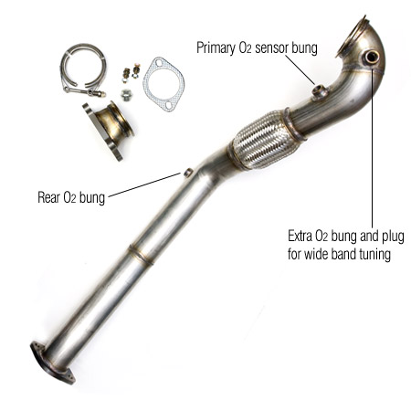

Things you NEED to know: Downpipes for Mazdaspeed vehicles are manufactured in two different styles. The first style is generally referred to as just a "3inch downpipe", these units will replace your original downpipe and ONLY the original piece (these are generally coupled to a "race pipe" or "test pipe" *SEE DIAGRAM ABOVE*which removes your secondary catalytic converter). The other style is known as a "Long downpipe" or "Full downpipe", meaning the new part will replace BOTH your stock downpipe and also your stock "race/test pipe".
Downpipes are generally sold with two options. They are referred to as either being cat-less or as having a high flow cat (the term cat refers to a catalytic converter). A cat-less downpipe is exactly what it sounds like, it replaces your OEM piece with a new 3" downpipe possessing NO catalytic converters. One possessing a High Flow Cat, also, is exactly what it sounds like, it replaces your stock restrictive cat for a more efficient, higher flowing unit. Generally, cat-less downpipes provide a few more peak ponies and a more aggressive exhaust notes than pieces with a high flow cat, BUT at the risk of the car receiving a CEL (Check Engine Light). Note: If a downpipe contains a high flow cat it is generally a "Long/Full downpipe".
However, there are ways to help prevent this CEL by extending your rear/second o2 sensor away from the main flow of exhaust through the downpipe. Some manufacturers include these fixes with their products, while others do not.
Commonly spark plug de-foulers are used. The first is left alone and the second is drilled out to 1/2", seen here:
Companies also offer o2 extenders taking away the drilling work for you, seen here:

cpe guide for the MS6 attached (wow, it was like 0.2 KB below the limit for attaching )
worked like a champ for my install of the M2 dp
Question-
Looking at the pic included for the MS6 dp from ATP (shown below)
I thought the O2 and spare O2 bungs are the opposite- that is the primary is closer to the turbo?

On the M2, is that the before/after o2 bungs right next to each other at the top? lol, or is there a lower bung that isn't seen?

there are three bungs total on the m2, two at the top and one at the bottom. all the bungs come with plugs.
