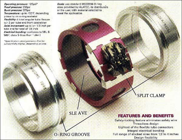

just noticed the Vband clamps good shit. is the rest of the dp and cat back vband as well?
Na, just the turbo connection. I kept mazda flanges elsewhere. Honestly... i'm not happy with my v-band clamp in this one. As i was tightening it, the opposite side of the threaded piece (which is supposed to be held still while you tighten) flexed all over the place. It felt like i was gonna break the clamp honestly.... so i'm in need of a higher quality clamp.
OMG I went through that on my 240. I swear they sent me Ebay aluminum foil vbands with my 1200 dollar turbo\Dp kit. I had to order a new set cause I wasn't comfortable with what was given. Or if your feeling like a balelr with your tax return you can spend $175 per clamp (and re-flange you piping) to run wiggins connectors........

lol, fuck that. If i start popping couplers, i'm just gonna weld tabs on both pipes, use a normal coupler and a long bolt to hold the pipes together lol. $free99.

hahahaa hey dj, vibrant has some really nice vbands, lil pricey, but no 175 a clamp lol
