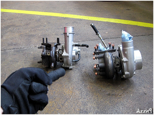

2008.5 Mazdaspeed 3 GT
ATP GTX3071 (1bar IWG)
Stock internals/stock clutch (71000 miles when turbo was added, currently at 91,000 miles)
Full Time Closed Loop tuning for both e85 and 93 oct
Using Hallman Pro MBC (23psi for now, soon to be 26psi)
Other mods are CNT catless DP, Corksport TMIC, PnP'd/VTCS delete intake manifold, and PERM Big MAF intake. (still stock cbe and ex mani)

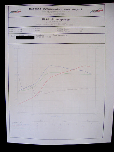

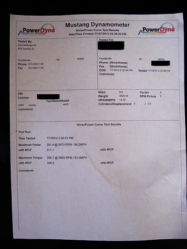

Dyno: Made on 23psi

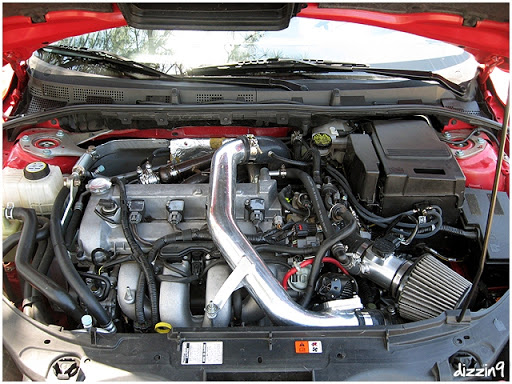

Engine bay:
^^ Old Setup
v v New Setup
HTA3586 Top Mount Turbo on Blow Through MAF (Currently 21psi Spring Pressure)
Stock internals/stock original clutch (96,000 miles on car)
Using OEM BCS
TurboXS FMIC
Should have some results up soon.
