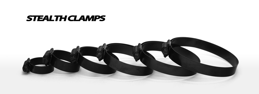

Just finished installing this intake this morning. The overall fitment was good and uneventful. Having said that, I am not a fan of the supplied t-bolt clamps and I think they are a bit overkill. As an example, the turbo intake pipe does an abrupt turn into the coupler to the turbo. I couldn't get the pipe into the coupler far enough to get the t-bolt clamp on the other side of the pipe hump. I think the idea is for the clamp to grab the silicone coupler evenly around the pipe and not grab the pipe hump, yes? I messed with the t-bolt clamp for a while but I couldn't get it seated right so I just used a standard hose clamp and got it to grab and hold the coupler evenly to the pipe on the other side of the pipe hump.
I would recommend just using standard high quality hose clamps for all intake junctions (black if possible). One of the only good things Sure ever made were those nice black hose clamps. I had them and liked them. I tried to find a place that supplied the black clamps and couldn't find them anywhere. Something like these would be really nice for your intakes.

my 3.5in intake comes with those clamps already. i don't think they were black.

My HTP 3.5" also used standard hose clamps. I was fine with them. They were unpainted/silver. Black would be a nice touch, but not necessary.

Didn't see this thread before. I do like the suggestion for these clamps. Slowly my included T bolt clamps on my 3.5" are disappearing. One broke during initial installation when I was tightening it down (believe me, wasn't even that tight). Put my BNR on this past weekend and the one around the turbo wouldn't even fit, so we had to replace it. Regular worm gear clamps are the best for functionality. I understand some people prefer the T bolts because they "look nicer" I guess.

T-bolt clamps don't risk chewing up couplers like some worm clamps can while tightening stuff down. So with that being said they have their purpose.
As far as popping tbolt clamps on your 3.5", did you check the size on the clamps? There are some that slightly vary in size, the largest being for the air filter to MAF housing IIRC.
I'm not trying to insult you, I just can't imagine breaking one. I've taken mine off and re torqued the hell out of them and still haven't come close to popping one yet. Still really happy with everything about this intake.
