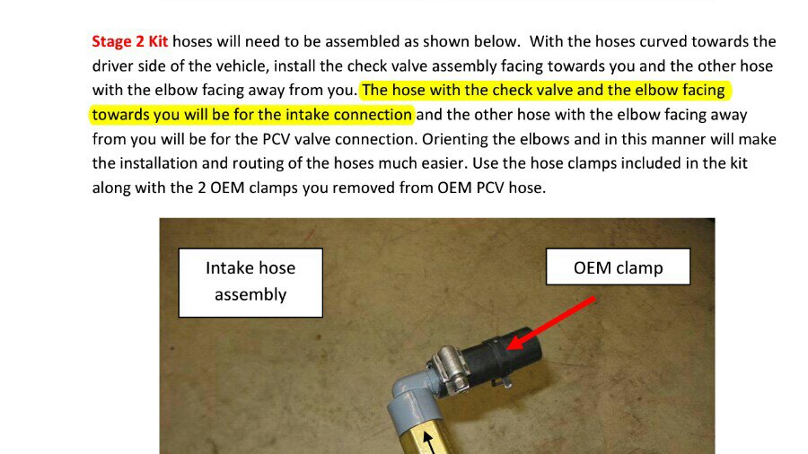

@agentgordon27; you installation is backwards... the check should go into the PCV not to the intake like you have it on your picture #2
That's only if your running the VTA kit. As long as he isn't running the VTA kit he's correct.

it doesnt say anything about vta on the instructions

Exactly, The picture Matches what jbarone explained there, the check valve should go on the PCV side and he put the valve going to the intake...
forget about letters, compare his picture and the picture on the instructions....
@jbarone; is it right or wrong the way @agentgordon27; installed his kit?
Look at his second picture

COMPARE THOSE PICTURES WITH HIS
Looks like were looking at 2 different sets of instructions. Read the screen shot I took. I think the ones that I have are the most recent.

yes there are 2 different sets, but he has the OLD kit so he has he needs to go by the OLD instructions, the ones im saying, The new kits have the valve coming right out of the OCC and in the old kits the valve is in the hose coming out of the PCV valve...
Sounds good @jbarone; you probably should clean this up so no one gets mis informed.

ask me how I know... I did this last weekend... following the wrong instructions, realized after i was done so i had to uninstall everything again... and at the first page of the instructions says for kits before this date use this and for kits after that date use that, so shame on us for not reading enough
That freaking PCV valve was a B#$ to remove the hose TWO TIMES!!

Note JBR changed the location of the CV, by popular demand.
There are two kits, one with the CV on the PCV side (pre 12/12), and another (post 12/12) with CV on the intake side. The CV needs to be set up to move air into the intake, closed to air moving back to the PCV.
The kit agentgorden is rocking is the newer setup.

then why on his pictures his CV is going into the intake side on the hose? not right next to the OCC like the instructions show?

if i was to do it like the newer instructions i was missing a elbow, that is the only reason i found out something was wrong with my install... i couldve gone and buy another elbow from home depot but had no car! so had to uninstall and follow the older instructions
Sorry, did not see that must be newer. Easier to fit CV so you don't have to wrestle it up that narrow space?
Don't think it makes too much diff, as long as it points the right way?
