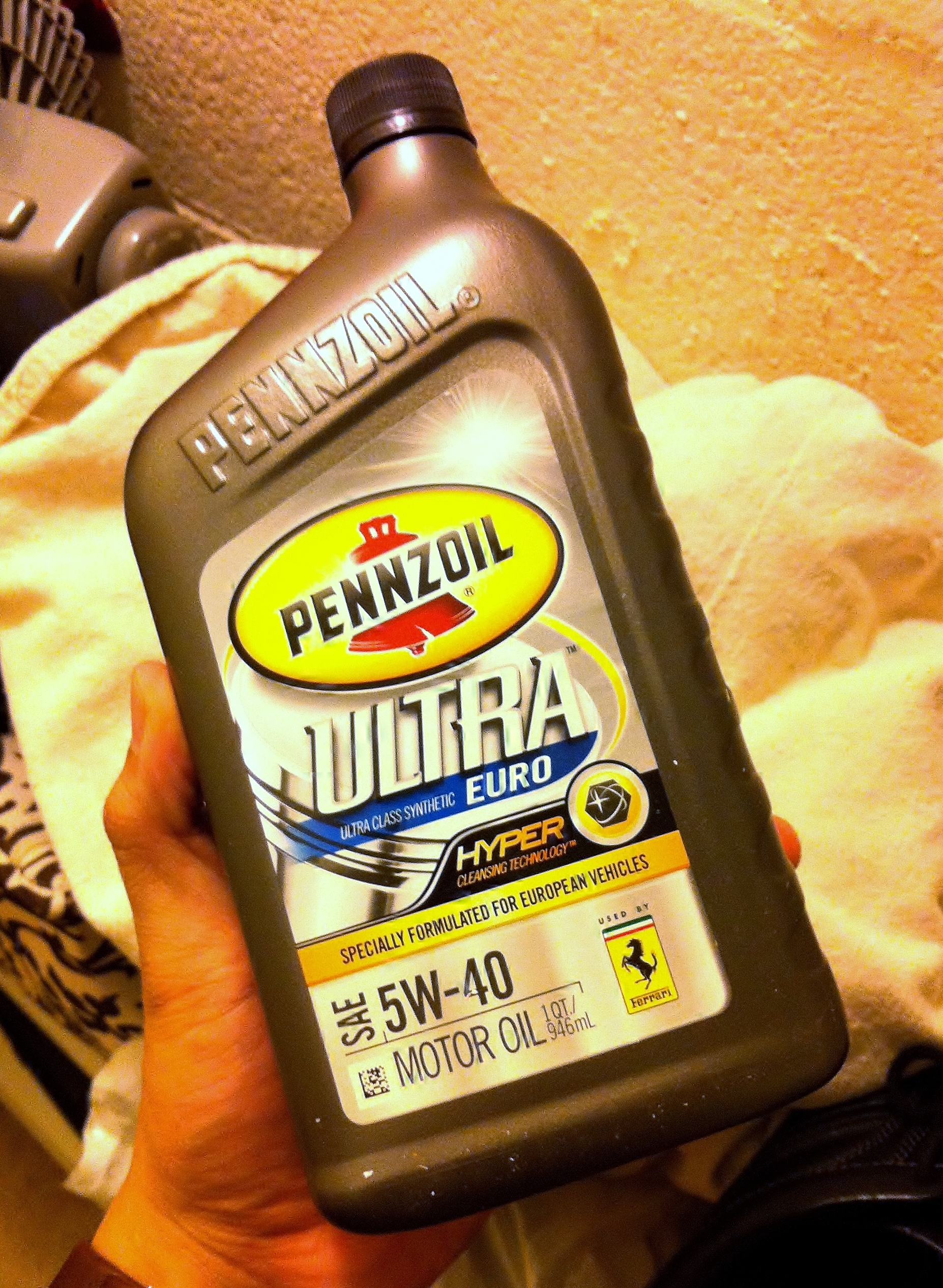

FYI - Penn Ultra is on sale at Wally World for $29 + a $3 off coupon = $26 on the 5 qt jug.
I picked up a few at that price!

What makes the Ultra different from the Platinum? From what I read the Platinum gets great reviews.

It's more expensive, so it has to be much better right? lol
Not sure to tell you the truth

Up here, the platinum is more expensive than the ultra.
And why would you put that euro 5-w40 in 10-40?
