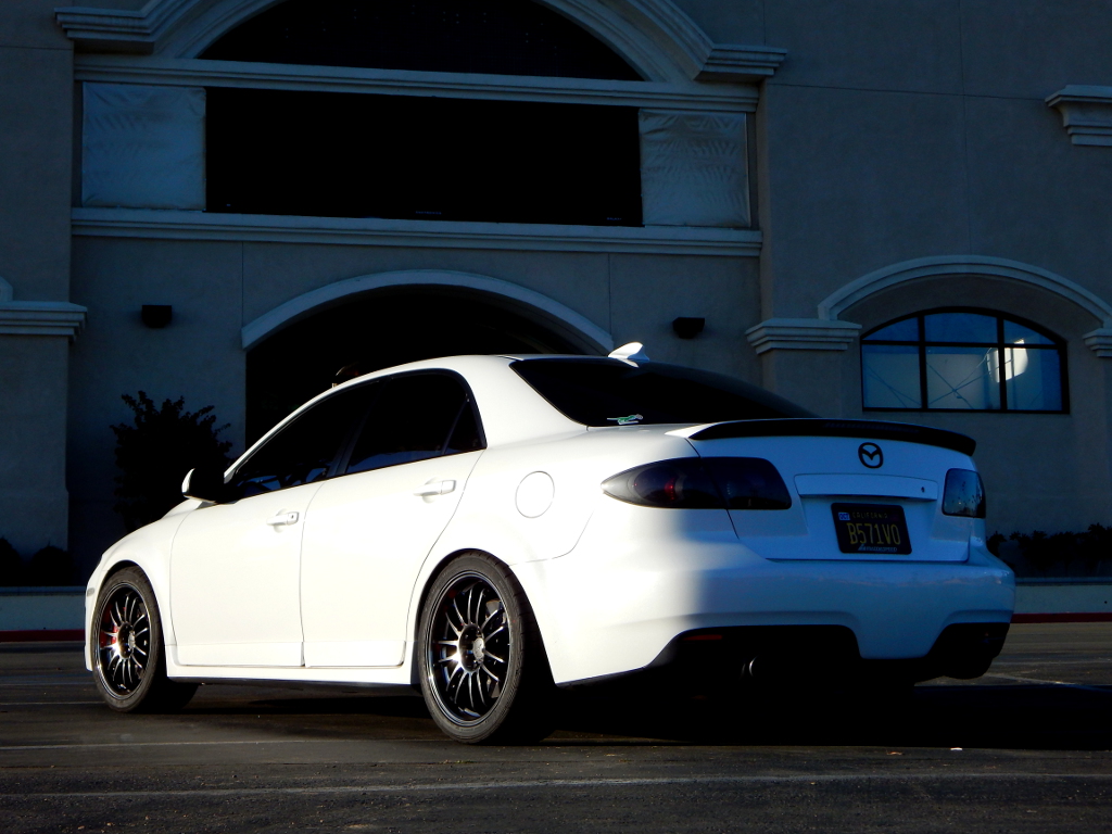

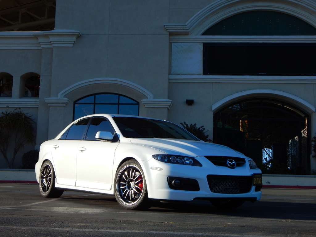

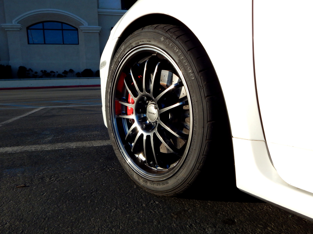

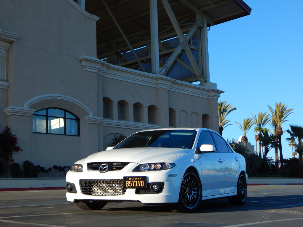

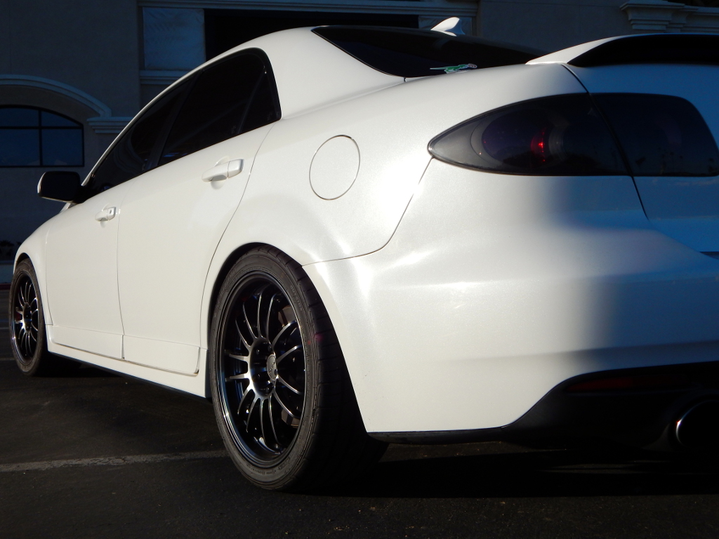

Default 18x8.5 +48 Rota SVN hyperblack with 265/35 HTR ZIII
I weighed the wheels, they are 19.4lb. Pretty light for an 18x8.5.
With the 265 and brembos, I had to run 3mm spacers up front to clear control arms and brakes with a few mm to spare. Rear goes right on, there might be a little rubbing on the inside felt liner.
