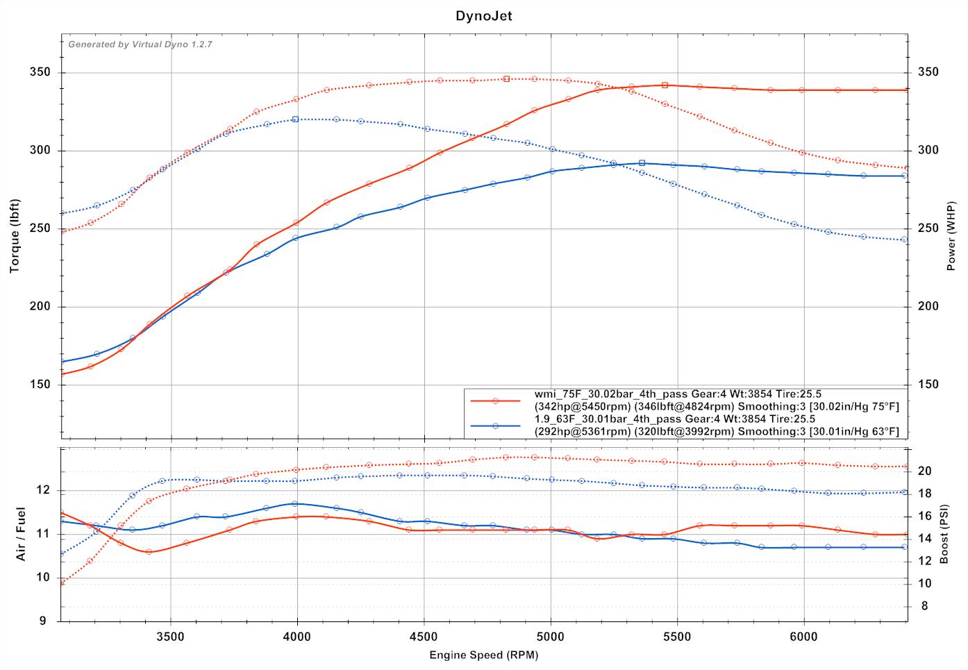

Here's where my car landed; the lower number being fully tuned on 91 only and the higher number on 91 + D07 50/50. With the 91 pump gas still being an issue, I am pretty much stuck at ~340whp which is a little sad considering my motor is brand new and fully bolted with meth. I could add E-85, go bigger meth nozzle or go 100% meth, but this is still my daily driver and so I want to stay within the confines of pump gas + some 50/50 meth.
D07 + 50/50 allowed a few more degrees of advance and more boost as you can see.

Why do you run that low boost (the S3 is efficient up to ~26 psi!)? Running less than 21 psi you cannot expect much more. If this is solely due to knock limitations I would strongly recommend E85 or much better fuel! You could also try to reduce ignition and increase boost further - however, imo at 20 psi the S3 is a waste...

There is definitely more power in that setup, 91ACN gas is the limiting factor at this point. 3 or 4 gallons of E85+WMI should get you to MBT and the BNR happy zone of 24-26psi.

Definitely agree, this setup is fuel quality limited 100%. A couple gallons of E85 would put me around the 350-360 mark.

Here is my gen pu on 91 only

350/360 vdyno cf 1.01 on 91 pump only

That is too small to read. What are #s ?

Idk why it shrunk it like that. Here is a better one

You guys must have magical unicorn piss 91 to get those numbers.

Well it certainly better than that Cali piss water they call gas down there.
But it works. 12* up top
