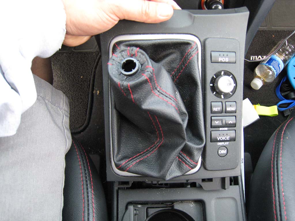

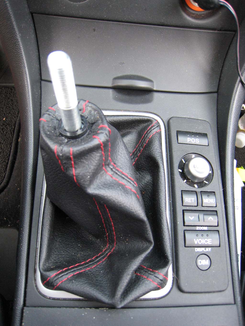

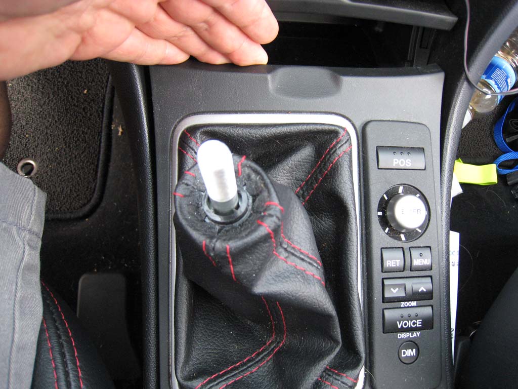

Start by removing the shift knob from shifter. Counter clockwise to remove.

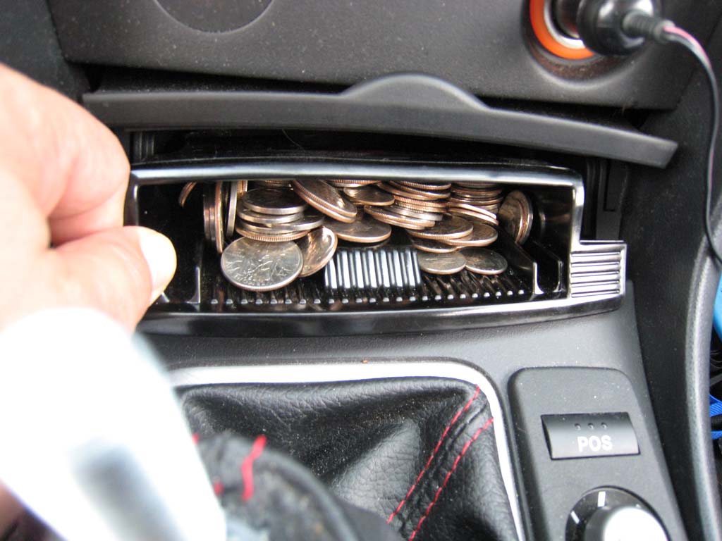

Next, give the ashtray a nice tug to remove.

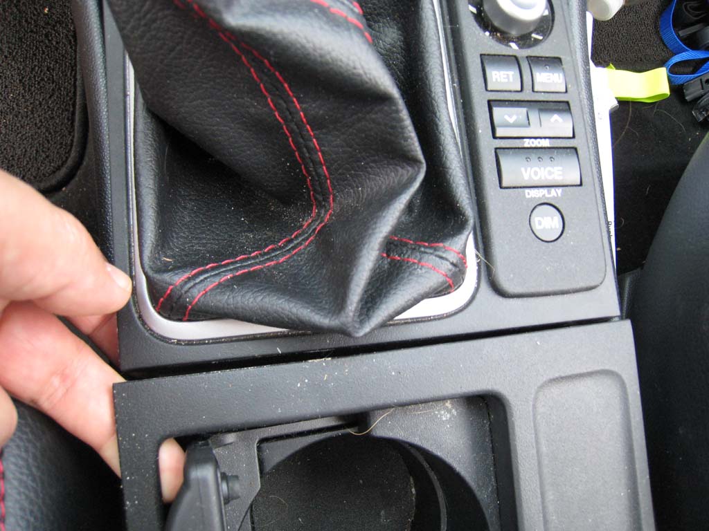

Now is a good time to give the front of the shifter boot plate a tug to remove.
While lifting the rear section of the boot plate, disengage the cup holder section.

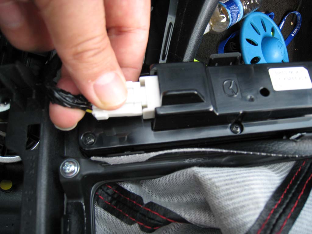

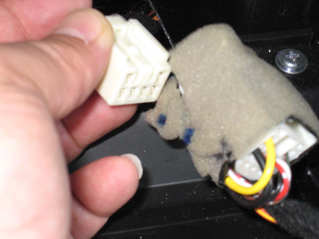

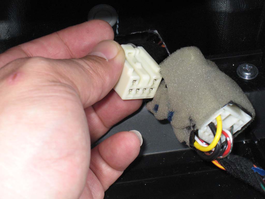

No disconnect the small white pigtail if your car is equipped with nav.

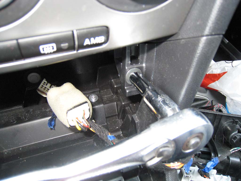

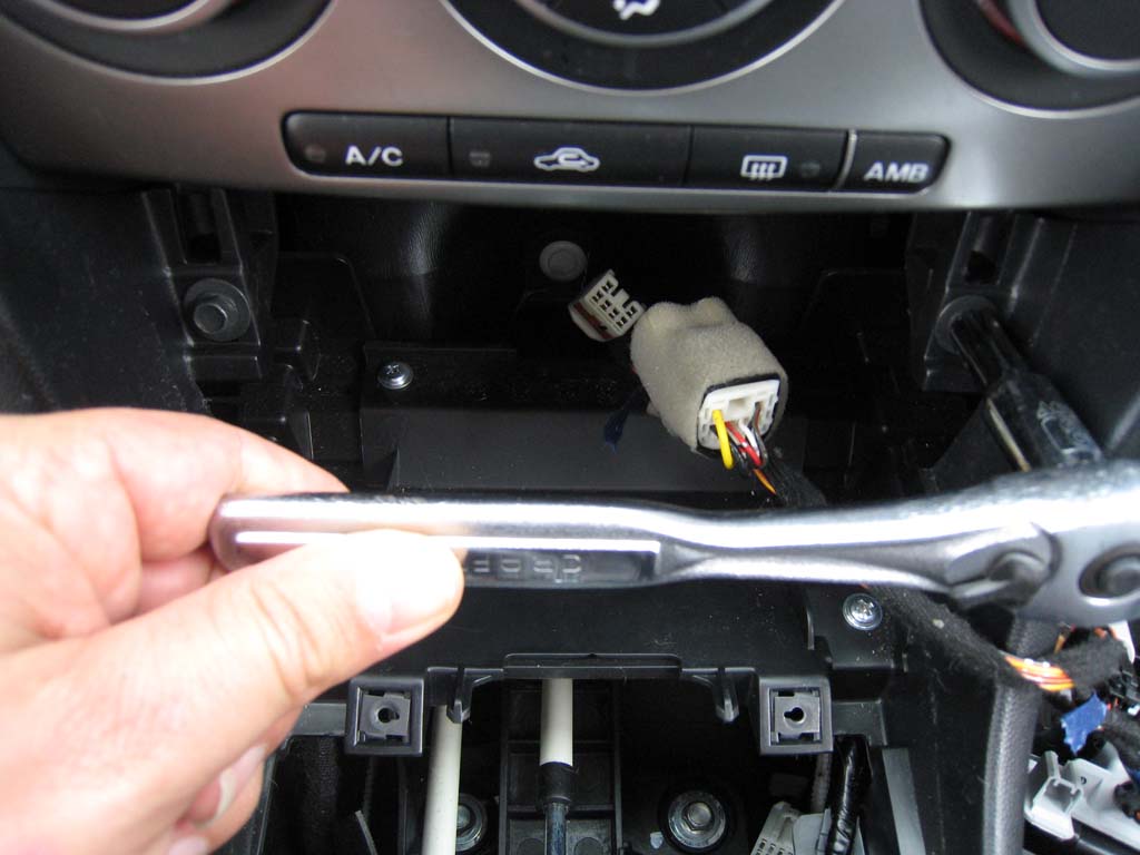

Remove these two 8mm/Philip head screws next.

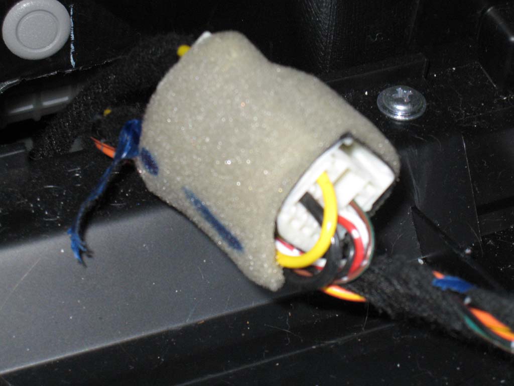

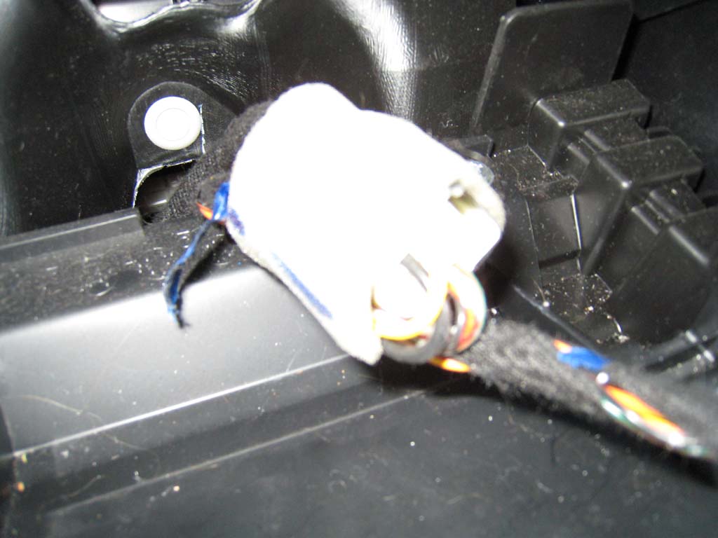

Locate the above pigtail. You want to disconnect it, but you may have to trim off the foam and electrical tape that mazda so kindly wrapped for us.

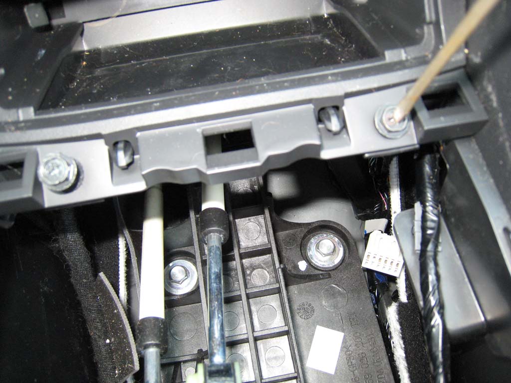

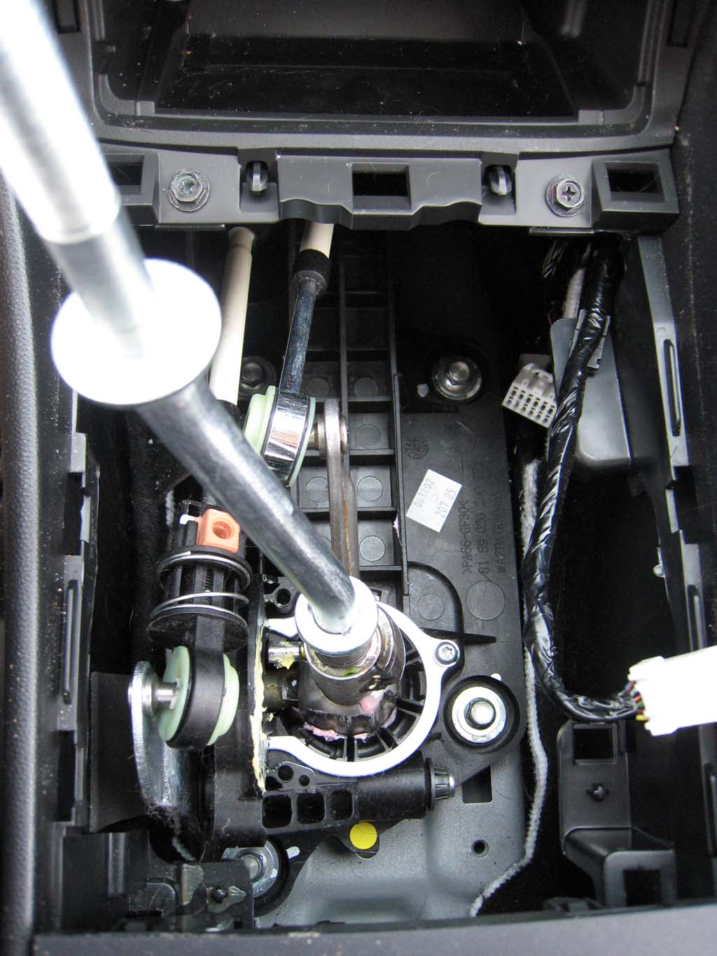

With the 8mm socket, remove these 2 bolts securing the center console to the front dash piece. Also, open up the rear console and remove the two 8mm bolts securing it to the floor. Once removed, Pull the console out and stick in the back seat to give you some room to work with.
Here is what you should be seeing now. The stock shifter assembly. Pay attention to the orientation of the cables and hardware.
