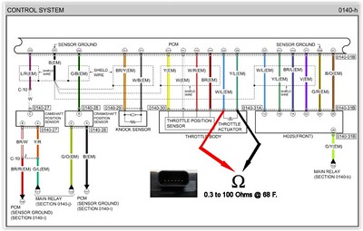

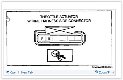

1. Disconnect the throttle actuator (at the throttle body) connector and check resistance of the throttle actuator motor as shown in diagram below.
If results are NOT as expected, replace the throttle body assembly.
If results are as expected, check for opens or shorts between the throttle actuator connector and the PCM.

- Throttle actuator terminal F and PCM terminal 2A
- Throttle actuator terminal E and PCM terminal 2B

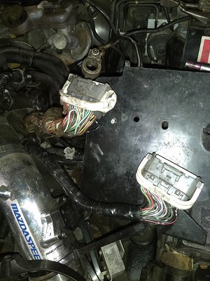

Testing the harness from the plug into the actuator and to the plug into the engine computer is easy. This is the OPEN CIRCUIT test listed above. The pictures in instructions above are a little confusing so here are some pics of which pins to back-probe with the your multimeter in CONTINUITY MODE. You need the needle type back-probe ends. The regular probes that come with a multimeter will not work. They are too thick and too short.
Just unplug both the plug into the actuator and the plug (the one closer to the front of the car) into the computer.

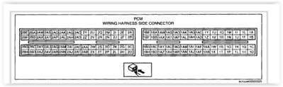

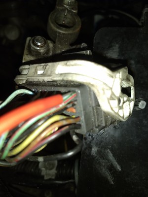

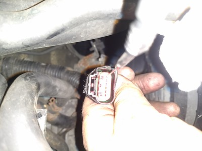

I started with checking for an OPEN CIRCUIT in the harness. With the multimeter in continuity mode, preferable with an audible alarm for when you have continuity, put either probe all the way into pin F of the actuator plug shown in my pic:

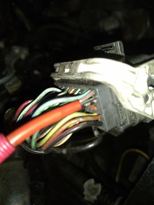

And the other probe all the way into the back of the corner pin 2A of the plug that goes into the computer as shown in the pic:
Its the red/green wire. Very top corner wire. Push the back-probe until it bottoms out and makes contact with metal.
If you have continuity then that wire is transmitting to the PCM.
Then go to the next connector in the throttle actuator plug, pin E, like so (sorry about the washed out picture):
and then move the back probe in the computer plug into the pin 2B just below as so:
Again you should hear a tone from your multimeter showing continuity.

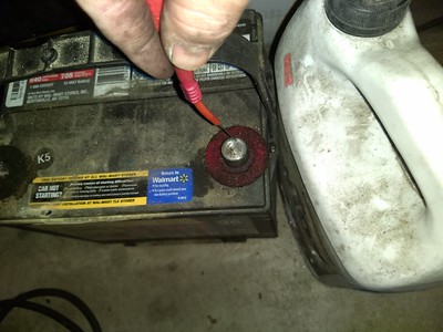

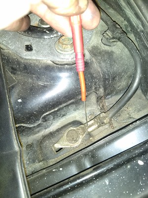

This time, as per the instructions, with your multimeter in CONTINUITY mode, you push either back-probe into PIN F (or E) of the throttle actuator and touch the other back probe to 1. the positive of the car battery and 2. The ground of the car. Neither should show any continuity. If they do its because you have a bare wire touching metal in the harness between the 2 plugs.
An easily accesible ground is next to the battery. Now is a good time to remove it, clean it with some mechanics sandpaper or scotch pad or whatever and reinstall it.
and
And then use the same pin in the throttle actuator plug and touch the positive car battery terminal (my battery was out, but you can leave yours in)
Now move the back probe to the other pin in the throttle actuator plug and touch the other probe to the positive battery terminal and then to ground.
You should NOT get continuity in either case. If you do, one of the wires is exposed in the harness and touching metal. You need to find and wrap it in tape and protect it from happening again.

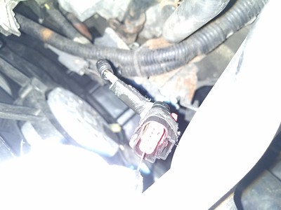

After a 3rd limp mode episode, I ended up changing the throttle body assembly with a Spectra Premium TB1025 unit from Amazon for $360. All seemed fine until I test drove the car. It went into limp mode with CEL and traction control light (a first) within 3 blocks. I checked the plug into the assembly and it seemed to be connected even though the red tab would not lock into place. Maybe she lost connection...not sure.
