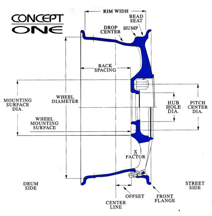

Wheel/Fitment Terminology
Offset - "The offset of a wheel is the distance from its hub mounting surface to the centerline of the wheel." - TireRack.com

Generally 8-8.5" wheels are accepted as mildly aggressive and a healthy size wheel for us. Whether you want to run 17s, 18, 19s, or bigger tho is on you. 16s are the smallest you can run with the factory brakes. Right around a +35 offset is accepted as a fairly aggressive yet acceptable offset for these cars. Should sit you close to flush with the fenders without going overboard. Remember the lower the offset the further from your strut/closer to your fender the wheel will be. Higher offset draws the wheel inside the well closer to the strut. You're going to need to break out a tape measure/ruler to see how much offset & width you're willing to run.
Just for the record...zero and negative offsets are ridiculous. Even for the Aggressive Thread.
