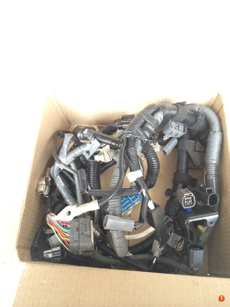

So I had the opportunity to put the rear o2 in today and absolutely nothing changed. AFRs were still stuck at 14.85 and I even did a hard reset on the battery and reflashed my map as well. In all honesty I was kind of expecting this but it's better to know for sure than to wonder. At least this came in the mail today so hopefully this will remedy this issue: http://img.tapatalk.com/d/14/06/03/zu2u6esa.jpg
msantana101 06-18-2014 04:12 PM
So it came down to being a bent ecu pin that was causing my AFRs to stay stuck. Fucking wow. I'm extremely happy and relieved now but still cannot believe that was the issue and that it was overlooked for so long. Amazing...
