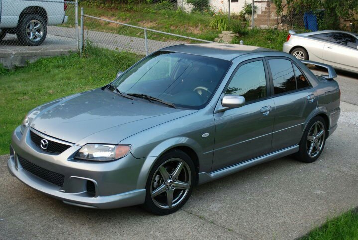

Sorry for not posting the pics sooner, I finally had time to pick up the car from my sisters house. O2 sensor is not plugged in and I cant find where it goes. I haven't even checked the other one. The MAF looks rigged. None of the guages work (they light up though) except for stock ones. There are 3 switches in the glove labeled boost, ECU and MAF (the one labeled boost has an led that lights up when you switch it on).

wow, a VTA BOV on a NA car... does the boost button do anything but light the LED ? you might have the best MSP ever, go all motor...

That's for sure just a protege exhaust on it. Is the CEL on?
Oh, that dual pod on the steering column is a HUGE lead possibly. Are those two pods molded into it? There was a guy years ago making them.
luciddream (09-29-2014)
Yes, they are molded in like it was made for that car. fits nicely "Will the previous owner of this car, please stand up!"
Thats it! So if I go all motor, what are my options?
Right now it idles bad, almost turns off. Once it is rolling, it is not bad. I will give it a quick tune up soon and hopefully that will help. When I press the throttle, its like an on and off switch. Its either reving or not. I cant make it rev to 3000 rpms and hold it. Kinda wierd.

The plug for the o2 sensor is on the trans, can see that. But I think the two won't match, different plugs from protege to speed. Wondering if the ecu was swapped or reprogrammed to non turbo. Engine bay looks clean overall.
Thats the same thing i was wondering. How would I know it the ECU was swapped or reprogrammed? as far as the o2 sensors, can I buy different ones or splice in the right connector? And is that why its running rough you think?
Another thing I thought of, is there a VIN on the engine? I'm sure there is, I will search for that.

There is a sign it is the MSP motor, right on top. The valve cover has the studs for the plastic cover. So I am going to guess, the guy had turbo issues (factory manifold by Calliway was made with high-quality plastic, and cracked worse than Whitney Houston on a bender) and probably just slapped the OEM manifold and exhaust, and dropped it off.
The primary O2 will get that thing running like shit when it is not connected. The question to ask, is if the O2 sensor is any good. Probably not. I would totally park it until you figure out it's running. From the MAf wiring looking hacked up, to the 20 piece intake with a BOV on it) and the wiring mess from hell.
So this is a present for you. F L O P T I C A L . N E T has protege wiring, and service manuals.
