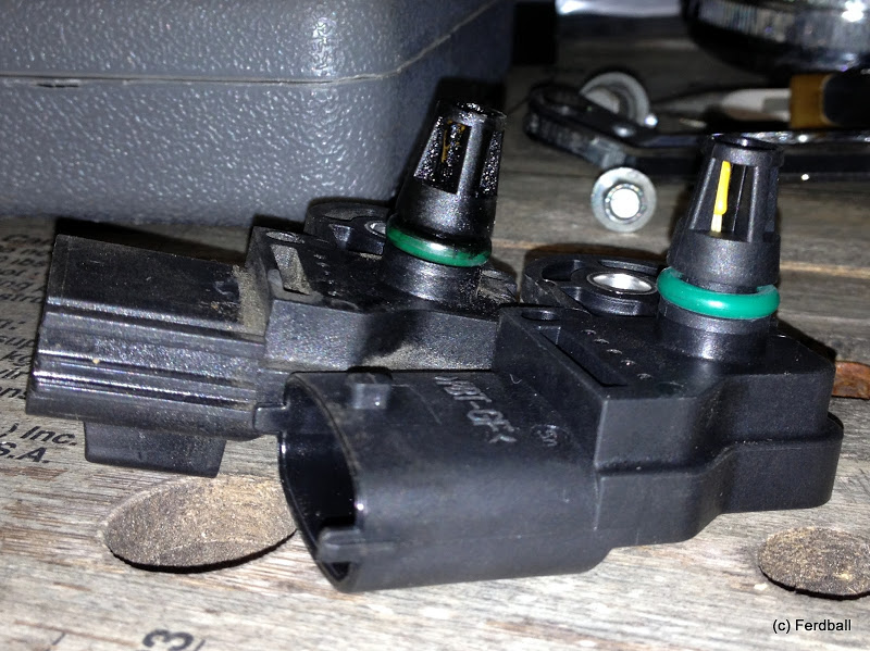

Your MAP sensor is what the ECU uses to read boost pressure. The stock Manifold Absolute Pressure sensor (MAP) is a 2.5 BAR unit, which tops out around 23-24psi, and looses accuracy around 22-23psi. If you want to accurately see pressures in that range or over, regardless of BT or K04, it's a wise idea to upgrade to at least a 3 BAR sensor. This is important even if you want to run boost pressures around 19-20psi, since the throttle cut and fuel cut settings will be at or beyond the point in the stock sensor range where things get fuzzy, so they may not work consistently, work as expected, or even work at all.
In the past this meant trying to find an overpriced sensor,usually in the range of $90-$125, and then having to cut the OEM plug off and solder the wires for the correct plug. There was a premium price since the MAP used by Mazda not only reads boost pressure, but has a built in Temp sensor, which even now, years later, is a nice touch, and fairly unusual in the USA.
Frankly, it was both expensive & a PITA, and that kept many people from making a very intelligent upgrade.
NO MORE-
3 BAR MAP + PNP Harness
no soldering, plug n play, completely reversible to stock, and can be re-sold later as a kit if you stock out.
Under $100 for everything!
Ballenger Motorsports
Bosch 3 BAR MAP with Temp - $29.99
their PN SNSR-03085
Bosch # 0 281 002 845
Home » Shop » Sensors » Pressure Sensors » Bosch 3 Bar TMap Map Sensor with IAT
Plug-n-Play Mazdaspeed MAP Harness - $60 shipped
The OEM Mazda MAP sensor uses a proprietary connector. This harness will convert that connector into a more standard Bosch connector for use with a wider range of MAP sensors.
Mazdaspeed MAP Harness - Bitwise Motorsports

For those who are tuning with VersaTuner this is the section that you need to look at:
The MAP Scale Additive corresponds to the Offset value above, MAP Scale Base Multiplier is the Scalar A and the MAP Scale Second Multiplier is the Scalar B.

Can i use this sensor with the plug n play harness?
Does this unit has the temp. Sensor included?
Bosch 0 281 002 437
stonecold0469 is offline   Reply With Quote
 Old 06-15-2013, 10:45 AM   #15
86AmishMs3's Avatar
Location: Chambersburg, PA
Posts: 3,639   (View Stats)
Thanks: 7,921
Groans: 338
Bosch 0 281 002 437
I believe so...iirc correctly there are 2 3bar sensors out there...and the 437 will require a different calibration.

 Old 08-09-2013, 11:12 PM   #23
Ferdball's Avatar
Join Date: Apr 2008
Location: San Diego, CA
Posts: 1,340   (View Stats)
Rep Power: 493
Thanks: 666
MAP swap = EGR delete?
 Old 08-09-2013, 11:44 PM   #24
Micha's Avatar
Location: Beach Park Illinois
Posts: 3,436   (View Stats)
Rep Power: 2610
Thanks: 46,278
That looks nice ferd.
