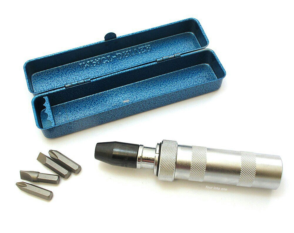

Impact wrench with screwdriver bits – remove rotor screws. Note: If you can’t get these out use a power drill + various size bits to drill out the rotor screws.

8. Now here comes the fun part. In order to remove the rotor, these screws need to come out. Get the Impact ready. If they do not come out easily, get the drill ready to drill out the screw heads. You really don’t have to replace these screws, the wheel hold the rotor on just fine. With the screws off, remove the rotor. If it won’t come off itself, use a bold in the threaded rotor hole, and screw it in until the rotor brakes free.

sorry to bump a really old thread @MATT DAMOND; but the two screws you need to remove on the rotor to pull off. Did those strip on you? The ones holding my rotors on are super soft and are stripping really easily. Any insight you can provide is useful.
Rotor screws are a PITA on any car that has them equipped, lol. If you can get your hands on an impact driver (Can tire) it'll save you a lot of frustration and time.
