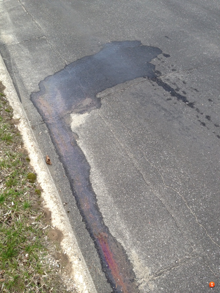

I did this on my old speed. Helped at the 1/4 mile track when doing back to back runs but was basically useless any other time. You dont need a FMIC to drop temps. Either meth or eth will do the job on top mounts just fine.
Chemical Intercooling > Mechanical

Sprayed for 5 minutes continuously. Yup. Not using this at the track.
