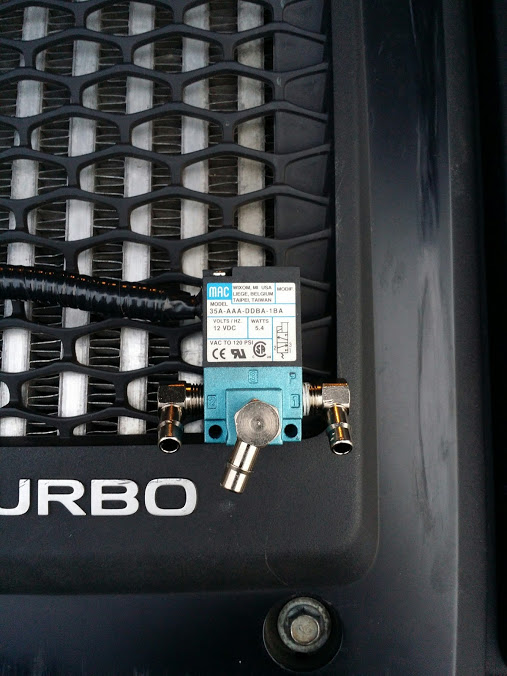

Don't think I posted a photo,here is one.

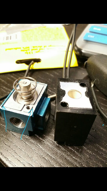

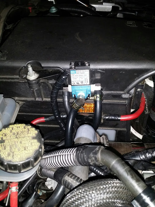

ImageUploadedByTapatalk1411523054.012088.jpg here's mine... Just installed it tonight... Car runs like a champ

As a side note, does anyone know if these little paths in the bottom part of the EBC do anything?
I was worried about the seal to the top part so I put a very very minimal amount of silicone there to provide a light seal so that that there is no air coming through the plunger opening affecting the ports... but now I wonder if those paths are there for a reason. It really does look like there is a gasket supposed to be there though... kind of like the OEM BOV flange gasket.
Finished product:
